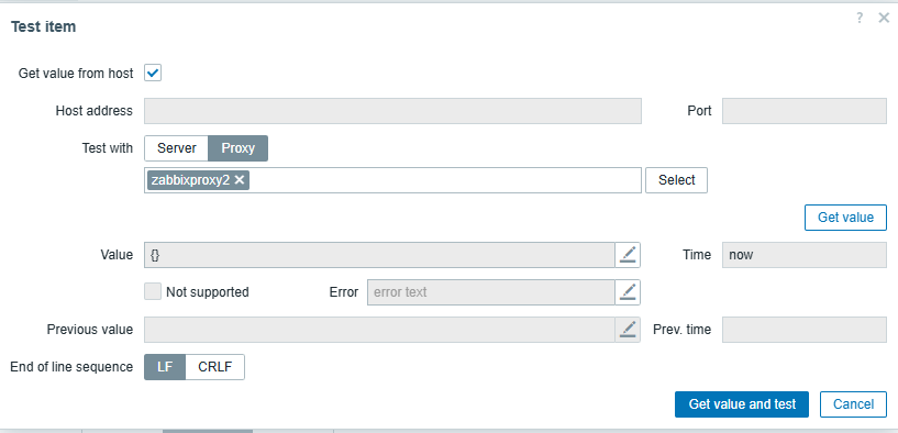

    2. However if I take the same json response body from my python script and use it for my HTTP Agent item it only returns this result {}. Here is my complete json response body being used
    "jsonrpc": "2.0",
    "method": "problem.get",
    "params": {
    "output": "extend",
    "countOutput": "true",
    "selectTags": "extend",
    "tags": [
    {"tag": "status", "value": "offline"},
    {"tag": "technician", "value": "delvalle"},
    {"tag": "device", "value": "camera"}

    This is the result using the HTTP Agent item test button
Name:	Screenshot 2025-03-31 101645.png

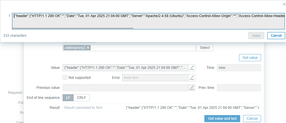

        If I change the "Retrieve Mode" in the HTTP Agent GUI to "Body and Headers" I get all the header values but still no body values
Name:	Screenshot 2025-04-01 150434.png
