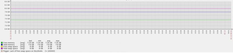

All good so far , except that we keep getting alarms about 'Free memory' all the time , but when i take a look at the graphs no trace of the problem
for example just yesterday we received this alarms many times , when the graph looks like this
When we get these alarms :
AT Tue 12/1/2015 12:28 PM Trigger: Amount of free RAM on the server Server for last 30 min less than 10% Status: OK Last value: 7.34 GB Trigger URL:
