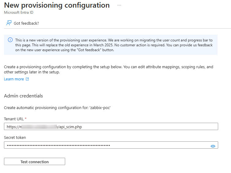

    I am currently configuring SCIM user provisioning for Zabbix version 7.2, following the official documentation

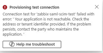

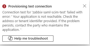

    After completing the configuration and testing the Test Connection from Azure AD, I encountered the following error:​

    The requested endpoint is not supported. (HTTP 400 Internal Server Error)
    • Configured Azure AD SCIM provisioning as per Zabbix documentation.
    • Enabled SCIM API in Zabbix UI (Administration → Authentication).
    • Generated a SCIM API Token with Super Admin privileges.
    • Configured Nginx to allow api_scim.php.
    • Checked file permissions for /usr/share/zabbix/ui/api_scim.php
