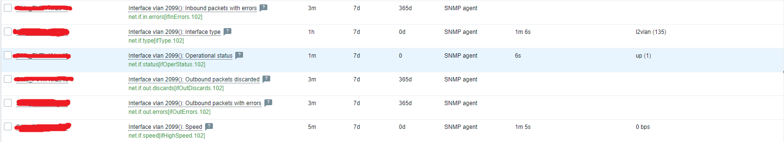

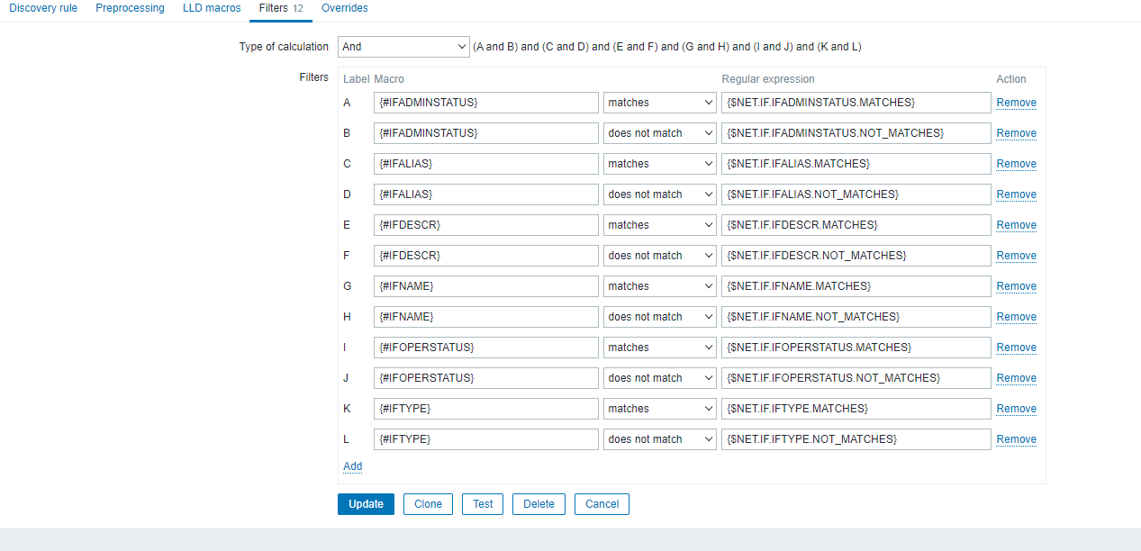

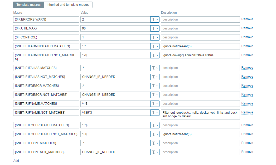

                      I tested it today and the vlan2099 is still discovered :/. I deleted the old host, created a new one.
                      Sending screens of my settings:

                      • Freezstyler
                        • Oct 2022
                        • 39
                        Well, I'm stupid . I changed macro for IF.IFDESCR and not for IF.IFTYPE. Now it's working like intended. Thank you very much, you were very helpful. Maybe if you have a minute, you can help me also with this one?
