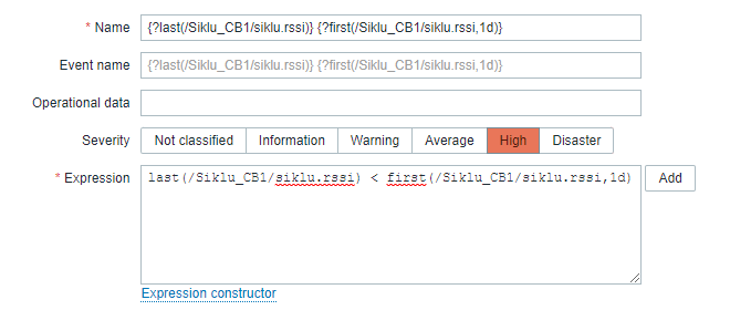

                      I tried it today, but it's not working, I got *UNKNOWN* *UNKNOWN* instead of values. Screens with configuration below :/

                      • Markku
                        • Sep 2018
                        • 1786
                        The documentation says that the expresssion macros are available (f.ex.) in "trigger event names​", not in trigger names.
                        Markku
                        • Freezstyler
                          • Oct 2022
                          • 39
                          Ok, I moved the macro to "Event name" and still got *UNKNOWN* *UNKNOWN*
