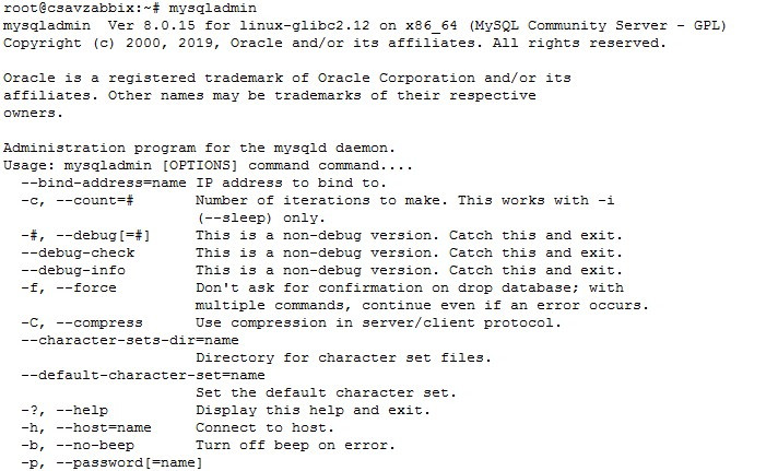

    Pero otros, se queja de que no existe el mysqladmin
    sin embargo el mysqladmin si existe y esta en el path por lo que no se que más he de hacer para poder usar esta pantilla, alguna sugerencia? muchas gracias
    root@csavzabbix:~# mysqladmin
    mysqladmin  Ver 8.0.15 for linux-glibc2.12 on x86_64 (MySQL Community Server - GPL)
    Copyright (c) 2000, 2019, Oracle and/or its affiliates. All rights reserved.
    Oracle is a registered trademark of Oracle Corporation and/or its
    affiliates. Other names may be trademarks of their respective
    owners.
    Administration program for the mysqld daemon.
    Usage: mysqladmin [OPTIONS] command command....
      --bind-address=name IP address to bind to.
      -c, --count=#       Number of iterations to make. This works with -i
                          (--sleep) only.
      -#, --debug[=#]     This is a non-debug version. Catch this and exit.
      --debug-check       This is a non-debug version. Catch this and exit.
      --debug-info        This is a non-debug version. Catch this and exit.
      -f, --force         Don't ask for confirmation on drop database; with
                          multiple commands, continue even if an error occurs.
      -C, --compress      Use compression in server/client protocol.
      --character-sets-dir=name
                          Directory for character set files.
      --default-character-set=name
    gracias!!
