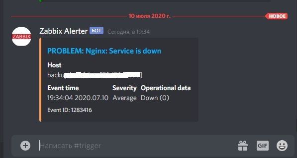

        • dzek
          • Apr 2012
          • 18
          works! thank!
