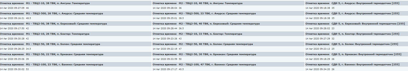

    Здравствуйте Уважаемые.
    Версия Zabbix 2.0
    Есть комплексный экран. Необходимо получить из него все данные.
    Раньше я качал HTML страницу и распарсивал из нее данные. Узнав про API решил получать данные по API.
    1. Авторизуюсь на сервере, получаю ключ.
    2. отправляю запрос
    {"jsonrpc": "2.0",
    "method": "screenitem.get",
    "params": {
    "output": "extend",
    "screenids": "67"
    },"auth": "authcode","id": 1}");
    Получаю белиберду(содержимое обрезал, т.к. много буков):
    {"jsonrpc":"2.0","result":[{"screenitemid":"20","screenid":"3","resourcety pe" :"0","resourceid":"433","width":"500","height": "12 0","x":"0","y":"0","colspan":"1","rowspan":"1", "el ements":"0","valign":"1","halign":"0","style":"0", "url":"","dynamic":"0","sort_triggers":"0"},{" scre enitemid":"21","screenid":"3","resourcetype":"0"," resourceid":"387","width":"500","height":"100","x" :"0","y":"1","colspan":"1","rowspan":"1","eleme nts ":"0","valign":"1","halign":"0","style":"0","u rl": "","dynamic":"0","sort_triggers":"0"},{"screen item id":"22","screenid":"3","resourcetype":"1","reso ur ceid":"10013","width":"500","height":"148","x":"1" ,"y":"0","colspan":"1","rowspan":"1","elements" :"0 ","valign":"1","halign":"0","style":"0","url": ""," dynamic":"0","sort_triggers":"0"},{"screenitemid": "23","screenid":"3","resourcetype":"1","resour ceid ":"22181","width":"500","height":"184","x":"1" ,"y" :"1","colspan":"1","rowspan":"1","elements":"0" ,"v align":"1","halign":"0","style":"0","url":"","dyna mic":"0","sort_triggers"
    :"0"},{"screenitemid":"24","screenid":"4","reso urc etype":"0","resourceid":"392","width":"500","heigh t":"212","x":"0","y":"0","colspan":"1","rowspan ":" 1","elements":"0","valign":"1","halign":"0","st yle ":"0","url":"","dynamic":"0","sort_triggers":" 0"}, {"screenitemid":"25","screenid":"4","resourcety pe" :"0","resourceid":"404","width":"500","height": "10 0","x":"1","y":"0","colspan":"1","rowspan":"1", "el ements":"0","valign":"1","halign":"0","style":"0", "url":"","dynamic":"0","sort_triggers":"0"},{" scre enitemid":"26","screenid":"4","resourcetype":"0"," resourceid":"406","width":"500","height":"100","x" :"0","y":"1","colspan":"1","rowspan":"1","eleme nts ":"0","valign":"1","halign":"0","style":"0","u rl": "","dynamic":"0","sort_triggers":"0"},{"screen item id":"27","screenid":"4","resourcetype":"0","reso ur ceid":"410","width":"500","height":"128","x":"1"," y":"1","colspan":"1","rowspan":"1","elements":" 0", "valign":"1","halign":"0","style":"0","url":"" ,"dy namic":"0","sort_triggers":"0"},{"screenitemid":"2 8","screenid":"5","resou
    то есть данных тютю, не отдает, что я делаю не так?

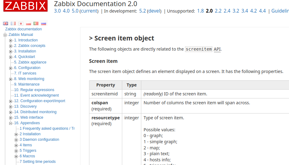

    Ну вообщето это не билиберда, а данные. Например:
    "resourcetype": "0",
    "resourceid": "433",
    говорит о том, что конкретно этот скринайтем содержит график и айди графика 433. Соответственно, при необходимости, для получения содержимого конткретного графика выполняется отдельный запрос. Это все есть в документации. И вообще, при работе с API привыкайте к тому, что в большинстве случаев это серия последовательных запросов, а не один супермега.

              После вызова "screenitem.get" вы получаете список айтемов экрана. Далее необходимо получить содержимое конкретных айтемов. Для этого пробегаете циклом по списку и смотрите на поле resourcetype - оно кодирует тип содержимого.
              Коды есть в документации:
              Type of screen item.
              Possible values:
              0 - graph;
              1 - simple graph;
              2 - map;
              3 - plain text;
              4 - hosts info;
              5 - triggers info;
              6 - server info;
              7 - clock;
              8 - screen;
              9 - triggers overview
              10 - data overview;
              11 - URL;
              12 - history of actions;
              13 - history of events;
              14 - status of host group triggers;
              15 - system status;
              16 - status of host triggers.
              Выше я уже писал что
              содержит график и айди графика 433. Следовательно, далее в соответствии с типом или дергаем "graph.get"-запросом данные этого графика, или напрямую картинку по url'у (мы авторизованы и айдишник у нас уже есть). Примерно так с каждым элементов в зависимости от его типа. Вы можете выполнять все запросы последовательно и синхронно; можете собрать в пулы по типам, сократив количество запросов; можете выполнить их параллельно, заморочившись обработчиком событий и синхронизацией. В общем, тут все ограничено только вашей фантазией и скилом программиста...
