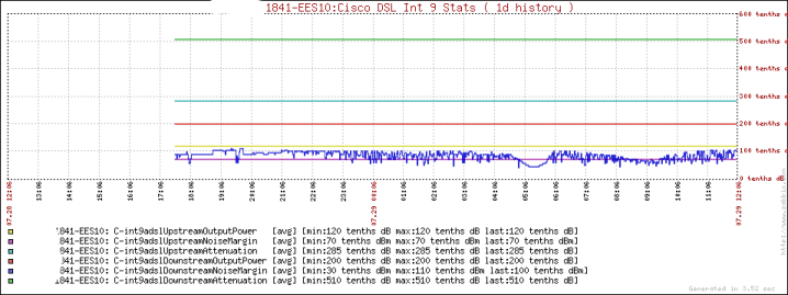

    Cisco router + DSL stat templates
    Attached is a Cisco router template with the usual interfaces, Cisco CPU usage and global IPSEC/IKE throughput. Also attached is a Zip file containing 24 templates for DSL interfaces stats and DSL up/down sync speeds, plus one unzipped so you can see it without downloading the zip. The reason for the 24 separate templates is that the index number of a DSL interface varies from one router to the next.
    If you walk the CISCO-IPSEC-FLOW-MONITOR-MIB of your Cisco device, you'll be able to see the indices of the individual IPSEC tunnels, so if you're interested in throughput on a specific tunnel [rather than global IPSEC throughput] then you can monitor the cipSecTunHcIn/OutOctets.n values, where 'n' is the index of that particular tunnel.
    Instructions
    1. Upload the Template_Cisco_Router.xml
    2. Create a device and link it to Template_Cisco_Router
    3. Navigate to Monitoring > Latest Data, scroll down to find an interface called ATM0-asdl or similar on the device you've just created and look at the index number. On the 877 for example, it might be ifDescr11 has a value of ATM0-adsl, thus the index number for that interface is '11'.
    4. From the zip file, upload the corresponding template, in this case Template_Cisco_DSL_int.11.xml
    5. Link this template to your device. Your new device will now have two templates linked to it.
    6. Sit back and watch the DSL line stats roll in. Eventually, you will see a graph like this:

      I've noticed on a few routers that the DSL stats go a bit haywire when the line drops, specifically I've seen the downstream noise margin figure can go up to 320,000 tenths of a dB. I suppose the only positive side effect of this is that you can see on your graphs when the line has dropped!
