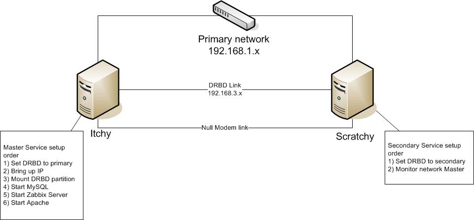

              I haven't had the chance to work on them much, things have been a lot busier than I expected.
              I've attached a Visio of the current setup. Most of my personal systems tend to use Simpsons names. :-)
              I'm also working on a 4 node version of this cluster where the Zabbix Frontend and Server run on a node separate from the back end. That setup is proving to be a little tougher. :-)

                Why are you using DRBD and not mysql replication?
                Unofficial Zabbix Expert
                Blog, Corporate Site
                • nelsonab
                  • Sep 2006
                  • 1233
                  Faster development time, plus I didn't want to have to deal with MySQL Master-Master index collisions which I did have initially when I first started. I'm going to try to setup a Master-Slave promotion configuration.
