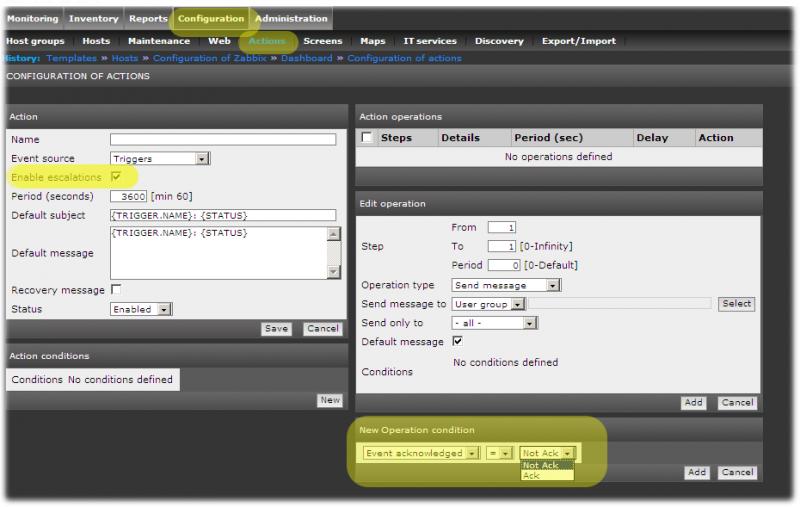

        In 'Config -> Actions -> Create New Action' ... if you check 'Enable Escalations' box a new condition appears/rise in 'Operation' options .... this condition will be 'Event Acknoledge' YES or NOT.

            I'm a little bit confused about your doubt ...
            But if you want stop a ESCALATION when a EVENT have a ACKNOLEDGE this screen can help to discover how:
