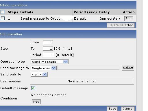

          How to delay an action?
          I have an action that runs a remote command and depends on 3 triggers.
          I want to delay the action for 5 minutes, if during this period trigger becomes false (OK), don't run the remote command, but if trigger remains true (PROBLEM), run the remote command.
          I don't want to affect the rest of actions by modifying Server configuration file, parameter SenderFrequency.
          Also I wouldn't like to affect other actions that depend on the same triggers by modifying triggers' expressions.
          Escalations will retard the execution of the command, but if during the delay period if trigger becomes false (OK), will the action be executed? or just aborted?. If it's aborted then it will work for what I want.

              Has anyone figured out how to do repeat notifications yet? Say a server goes down, my action will send out an email only once for the problem and once for the recovery. How do I set it up to repeatedly email me until the problem has been fixed?

                Take a look at:
                http://www.zabbix.com/documentation/..._notifications
                And remember to type a "0" in the "to" step so that the messages repeat to infinity until the problem gets resolved.

                  Yeah, I read that and tried it but the Recovery messages were also being resent to infinity even though I added the 'PROBLEM' condition. I deleted the Action and then recreated it with '0' in the 'To' step and now it works properly. Must be a bug with the 1.8.3 appliance. Thanks for your help.

                    Hey phoeneous,
                    Try to create more action in the below window for repeated notifications.
