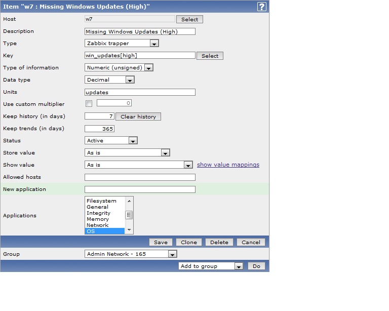

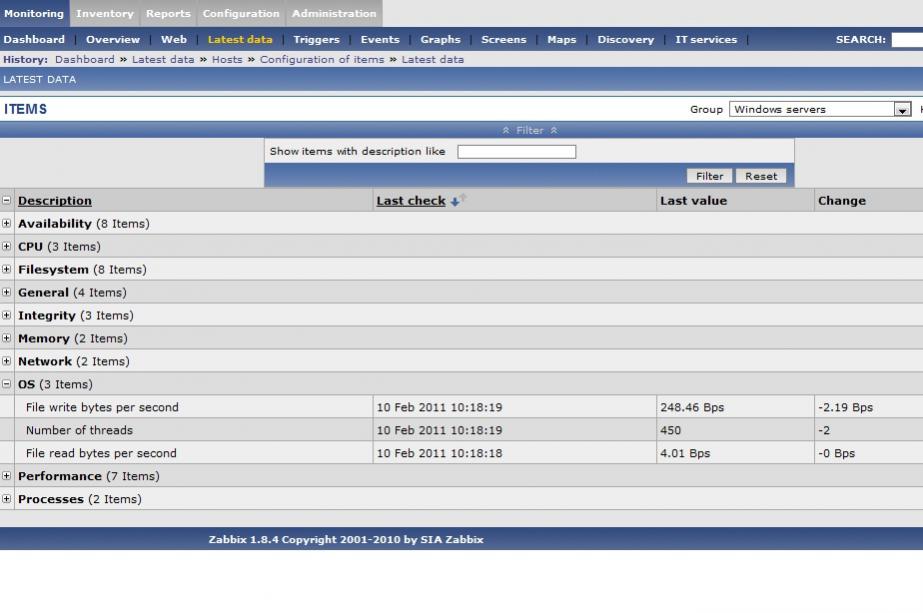

              • beeloo
                • Nov 2010
                • 62
                #22
                After I changed the extension from winupdate.ksh to winupdate.vbs. I don't received any error when I run it manually.
                C:\zabbix\wu>cscript winupdate.vbs
                C:\zabbix\wu>
                However, the Zabbix still not show up anything
                Here is I attached screenshot of one of the item configuration. If it works it should show up in the "OS" container. But it doesn't. Please advise. Thanks.
                • eger
                  • Nov 2006
                  • 95
                  #23
                  Is the location of zabbix_sender.exe correct?
                  Try running the command manually from the command line and see what the output is:
                  zabbix_sender.exe -z 10.x.x.x -s w7 -k win_updates[total] -o 5
                  This should send a '5' to the win_updates[total] key and should show up in the latest data. But the output should say if it is successful or if it failed.

                            • beeloo
                              • Nov 2010
                              • 62
                              #29
                              The strange thing is, the windows agent seems communicate to zabbix server fine because I can see other datas pulled from the windows 7 machine (it belongs to the "template windows")
                              • eger
                                • Nov 2006
                                • 95
                                #30
                                zabbix_sender.exe -V will tell the version.
                                I just tested on my installed and it works fine with 1.8.3 agent and 1.8.4 server.
                                In your item I noticed you filled out the units field. Is this an actual name or a special field for converting the value to a specified unit? I think this might be used to do unit conversion. Try blanking out this field and trying again.
