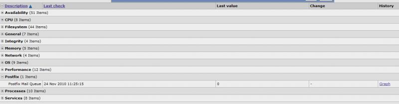

        Hi Frater, i've just checked the hostname (FQDN) in the agentd and its exactly the same as wrote it in the server even with case sensitive, i get the other statistics without a problem i´ve just realized that even the postfix items show as ACTIVE in the item configuration like the would be working fine, i just dont kown why they dont get any value nor appear in the latest data tab or anywhere else.
        there's is a way to monitor the zabbix sender or at least test it to see if its working???, by the way the item postfix.mailq just gives me the value of "0", all the time, i dont kown if this is correct..

        • bnaranjo
          • Nov 2010
          • 9
          Postfix Monitoring
          i've forgot to tell you that postfix.mailq is the only item that i do see in the latest data tab, the others just dont show anywhere... thanks

                Statistics seems fine in the server
                Hi Frater, sorry that i didnt get back at you sooner, i was out of town giving support in a branch office,
                i've already read the original link before i tried your script, and installed the other tools, that's why when i run the script with the zabbix user i get the statistics, as i attached them, i've also attached screenshots of logs in the zabbix server and postfix client, there are some errors of non supported items (due to the default linux template items), but nothing related to the postfix items, as you can see in the picture they seem ok in the config tab, but not showing info in the latest data tab. i tried the other command you told me /usr/bin/mailq and the queue is still 0, the volume of mails that i have is about 8000 per day (100k average)and i have a 1024mb uplink, i dont know if that is why i dont have mail in the queue.
                thanks for your help, once again
