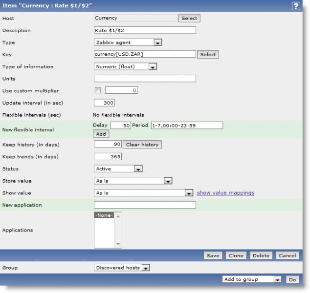

    After reading a weblog about monitoring the weather with Zabbix, it got be thinking about what else, besides computers, I can monitor.
    The following will allow you monitor currency exchange rates. Might not be something that many people will use, but the concept is there.
    Add to Server's zabbix_agentd.conf:
    UserParameter=currency[*],curl --silent 'http://themoneyconverter.com/$1/rss.xml' | sed -r "s/<title>/\n<title>/g" | grep "$1/$2" | cut -f2 -d"=" | cut -f2 -d" "
    create and item with a key currency[CC1,CC2], where CC1 and CC2 are the 3 letter currency codes that you want to convert.
    example:

              Old thread, I know, but having an issues with 16.4 Numbers and Currency monitor
              Hi All,
              I hope that this thread is still being monitored as it is quite dated.
              I have configured a item to monitor currency between ZAR/EUR as a test to see how this cool little monitor works.
              After finding that hte rss feed at "http://themoneyconverter.com" appears to now be different as to when this thread was initially created, I tweaked my item a bit and when running the command from cli, found it to return the correct information. it is returning, in my example item here (ZAR/EUR) 14.35541. when the item runs the userparameter, it was reporting that "Received value [] is not suitable for value type [Numeric (float)]. after some further investigation, I had found what would appear to be a bug in version 2.0. I am currently running 2.2 but tried to manipulate the script/userparameter so as to ONLY collect the first 5 characters in the result retrieved (so as to ensure that if this bug was still around, that this would pin it down to the bug being hte issue).
              unfortuantely, I am still receiving an error stating that data is invalid as shown below:
              Received value [14.35] is not suitable for value type [Numeric (float)]
              My userparamter is as follows:
              UserParameter=currency[*],curl -s 'http://themoneyconverter.com/rss-feed/$2/rss.xml' | grep -A 5 "$1/$2" | cut -f2 -d"=" | cut -f2 -d" " | cut -c1-5
              Bearing in mind that I am only a novice linux user (i.e.), Im sure I have done something wrong here..., I would appreciate any feedback as to what the issue may be. It would seem as though it is not recognising the data as being numerical for some reason...
