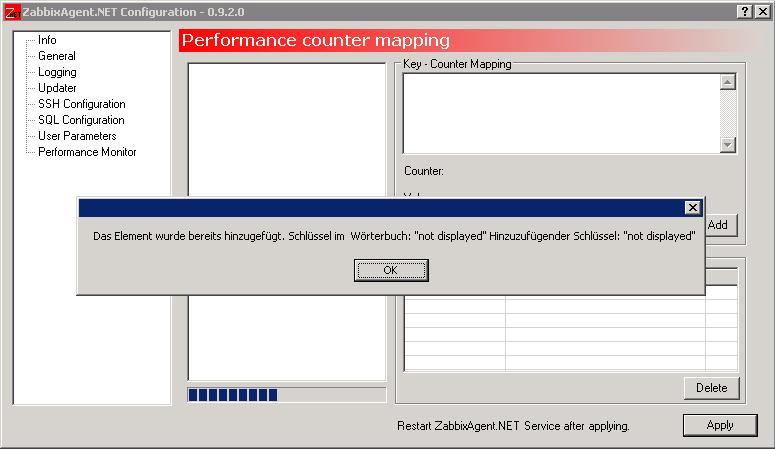

        hi,
        great work. i hope the update function will be implented soon
        and here is my first bug-report:
        look at the attached image, this happens on windows 2003 sp1 with exchange 2003. the mashine is fresh installed.
        ask if you have questions
        kyi

          Yiir! A bug Ill push it to Erisan and ask him to take a look at it

            kyi, will you try on a server without Exchange installed, i think maybe the counters is pushing the limits. Want to see if it the language or something else. Thanks

                k, i try it on an new installed mashine without exchange.
