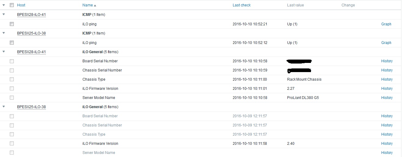

    Originally posted by Buaaa
    After import template into Zabbix i receive only 6 items - most of the Applications is empty. Why? How to fix that? Zabbix 3.
    All other "tests" - ok.
    Please help.
    Hi All
    I also have same problem on zabbix 3 installed on Debian 8
    Regards
    • michael.weber
      • Nov 2015
      • 121
      #62
      What Generation of HP Server are you using? What ILO Version is installed?
      • mahdiafa
        • Oct 2016
        #63
        I have DL380 G5 with iLO version 2.27 and DL380 G9 with iLO version 2.40

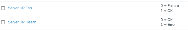

                                2. Zabbix web interface: Administration-> General -> Value mapping.
                                Create value map as follows:
                                1) Server HP Fan
                                0 ⇒ Failure
                                1 ⇒ OK
                                2) Server HP Health
                                0 ⇒ OK
                                1 ⇒ Error
