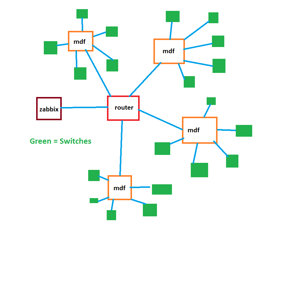

      I mentioned in my post that I already have dependencies where I can. There is no dependency I can add that will stop these from happening. Consider the picture below... the switches depend on the MDF's. The MDF's depend on the router. None of these ever go down though. There is no dependency I can add that will stop notifications when all of the switches go down.
        Currently zabbix is GoodEnough(tm) if not even perfect on defining and handling host dependencies.
        To have something outside that area it needs to be necessary to define metrics on top of multiple per host .. triggers.
        Sometimes it is necessary to have something like this.
        Typical case is horizontally scaled farm of hosts or few switches providing redundant paths using (fast) spanning tree protocol.
        In such cases you may be interested about fact that some number of backbone switches already is dead but as long as still is provides some number of alternative routes it should be not a problem.
        With that would be possible to hook under such master trigger that as long as it is between N and N+M paths trigger about critical problem should not fire and even some host (switch) critical alarms could be hidden.
        Nevertheless theoretically you can define dummy host metric which will depend on per switch availability metrics connected over "and" operand and some alarm can be displayed only when "switch_A_is_down and switch_B_is_down and switch_C_ ..." then theoretically should be possible to create dependency to hide some per switch alarms. That is only theory because so far it is not possible to create inter host trigger dependencies.
