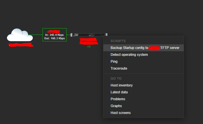

    ****I DID IT!!!! Just verified and this is working properly!! (quick backup from selecting on a map, I'll let you know when I get the automated backup script setup****
    Zabbix script to allow selecting a map icon and clicking backup for Cisco devices

    Step 3: Create the following user script in Zabbix frontend:
    Name: Cisco Running Config Backup
    Type: Script
    Execute on: Zabbix Server (could be other, just the way I did it)
    Everything else leave at defaults
    Commands box, copy and paste this:
    ./usr/lib/zabbix/externalscripts/CiscoDeviceBackup.sh {$SNMP_COMMUNITY} {HOST.IP} {HOSTNAME}

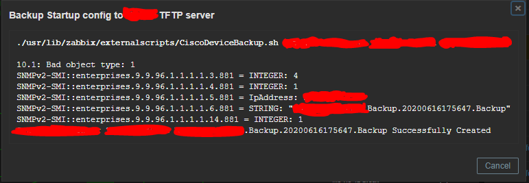

    Step 4: Test by going to the map, clicking on a Cisco device, and selecting Cisco Running Config Backup.
    There will be an error shown (just one) but it should still work.
    Then go check your TFTP server to ensure it copied correctly.
