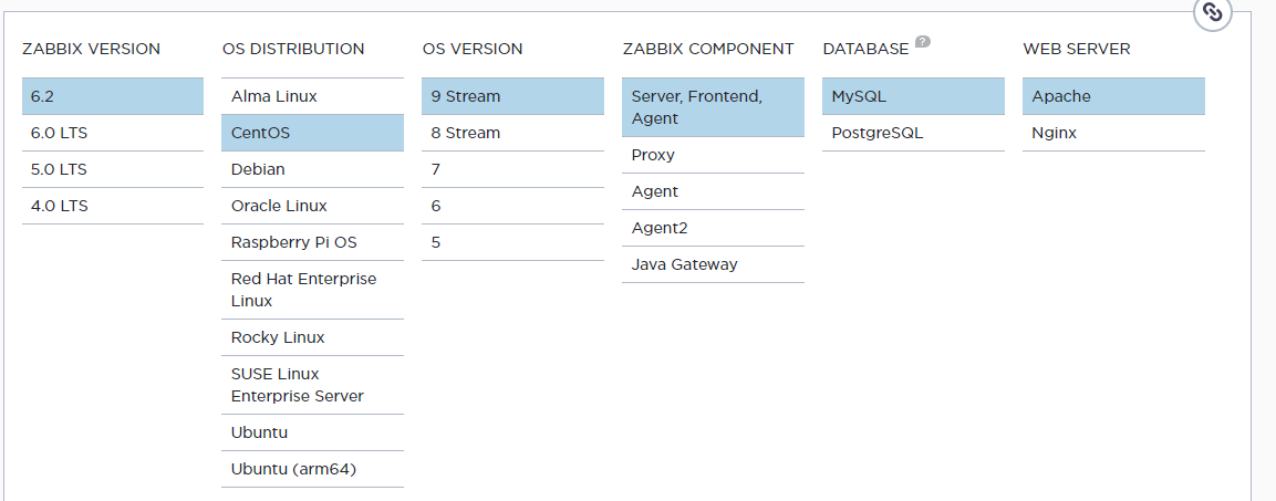

            How to get roadmap v6.4? When i click on Download it shows v6.2 only.
            Please share the reference link.
            Click image for larger version  Name:	image.png Views:	0 Size:	44.1 KB ID:	450847
            ​https://www.zabbix.com/roadmap

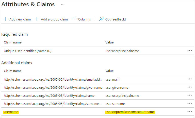

              Hope this helps someone else, we previously configured Apache to use Kerberos authentication from domain joined workstations and had our users defined as the Active Directory SamAccountName (eg davidh):
              We subsequently configured SAML in the Azure AD Enterprise Application registration to add an additional claim called 'username' where we then use the SamAccountName field from the account sync'd to Azure AD from our on-premises AD:

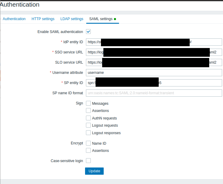

              Zabbix SAML integration was configured to use the custom claim field 'username':

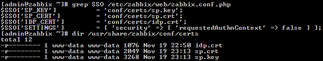

              Lastly download the Azure AD application certificate and store it as 'idp.crt' whilst creating a certificate for Zabbix:
              Created 'sp.crt' and 'sp.key' with the following command:
              openssl req -x509 -newkey rsa:4096 -keyout /usr/share/zabbix/conf/certs/sp.key -out /usr/share/zabbix/conf/certs/sp.crt -sha256 -days 1825 -nodes

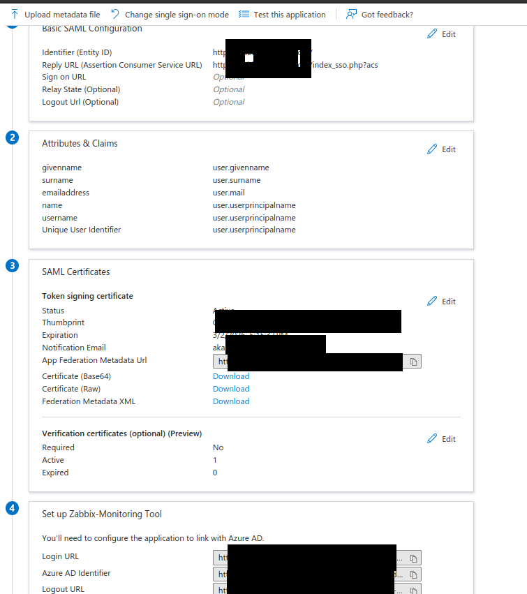

                I Have tried the steps mentioned in the post to do the setup but it's not working . Getting error-
                • Invalid array settings: idp_cert_or_fingerprint_not_found_and_required
                ​I have added the idp.crt in ~/conf/certs . Can someone please help ?​
Name:	Screenshot from 2023-03-03 13-39-37.png
