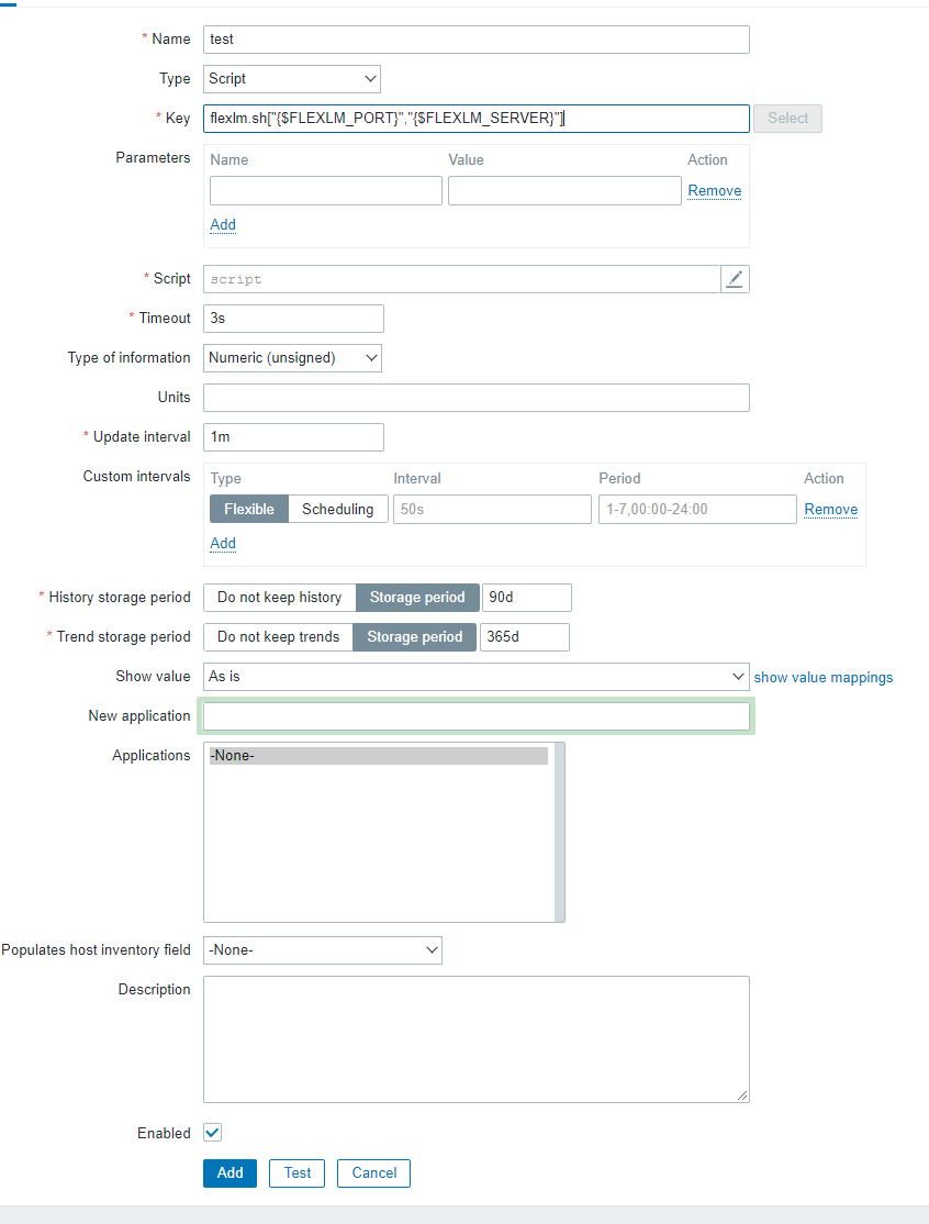

    I created a new template called 'FlexLM licence status', assigned to the above group. In Macros section of the template, I've created two macros, {$FLEXLM_SERVER} and {$FLEXLM_PORT} - I left the 'value' fields blank because I didn't know what to put there. Then within the template I created a new Item, with Type = Script, and the following item key:
    flexlm.sh["{$FLEXLM_PORT}","{$FLEXLM_SERVER}"]
    I then click Test, and in the 'Test item' box that popped up I set a value for both Macros (one specific server and one specific port), but when I click 'Get value' I get 'Cannot execute script: undefined return value'.

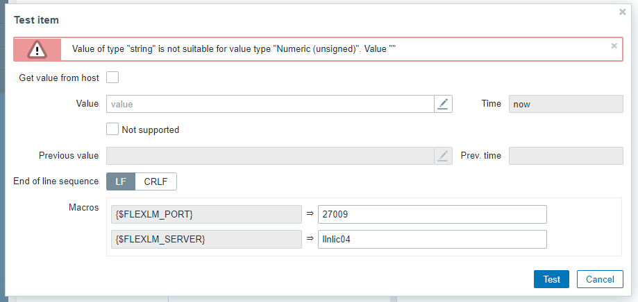

        Ah OK, it's good to know that about the variables - I think I may have created a red herring by trying to echo the variables in the script. So removing that, and going back to a single-line script, I'm now getting...
        Value of type "string" is not suitable for value type "Numeric (unsigned)". Value ""
        The result I'm expecting is either a 0 or a 1.

        I've attached screenshots of my item and the testing screen

          Hello, I've changed now to 'External check' but unfortunately I'm still getting the following when I hit Test:

            Is there a specific reason why you are using an empty string value in testing where in real case you expect an integer? Or do I miss something here.

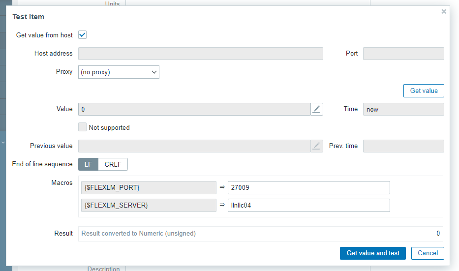

              OK I think I have progress. But I'm not sure what I did apart from rebooting the Zabbix server.
              I'm no longer getting the above error. Now, when I do 'Get value and test', it just gives a '0' regardless of what values I give to my macros in the test. Please see new screenshot attached.
              When I run the following command on the Zabbix server's SSH console...
              /usr/share/zabbix/externalscripts/lmutil lmstat -A -c "27009@llnlic04" | grep -c "license server UP"
              Then I get a '1', which is what I expect. And then when I change the above port to 27012, I get a '0', which is also what I expect. But for some reason in the Zabbix application when testing I get '0' for everything.

                To check, run this command on behalf of the user under which zabbix is running.

                  Thanks everyone for your input here. Turned out to be a very strange problem. Inside the script I re-wrote the command manually underneath the one that was there, and then commented out the original. And then it started working.
                  I had closely compared both lines and they were visibly identical. So the only thing I can think of is that when I copied/pasted the commend into my SSH console, some of the characters were a different format, or some kind of encoding issue during the copy/paste.
                  A good few hours that I spent on that problem!!
                  But it wasn't a waste anyway, as I've gained valuable info on Zabbix, and Linux in general.

                    I think script type item is meant to contain a javascript under "Script" field. Not pointing to a external script on "key" field. For such external scripts you should use "external check" type.
