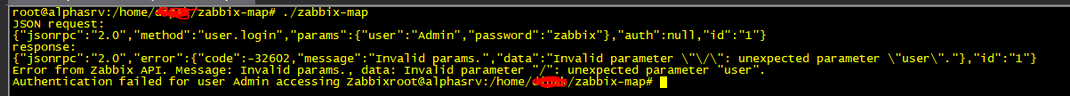

    I encounter with "Invalid parameter" error. Anything that I missed.

      Hi, have you been able to get it working on Zabbix 7.0 LTS?
