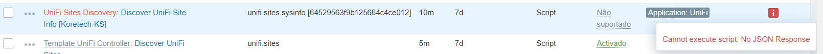

      Hey guys!
      It worked until the part where it discovers it on the website, but then it displays the error
      Can't run the script, no Json response, any ideas how to resolve it?​

        #19
        It's looking like this:

                • michael.weber
                  • Nov 2015
                  • 121
                  #24
                  Originally posted by tikoretech
                  yes michael... the problem continue...
                  I found the problem, and I will provide a fix int the github repo until friday
                  • tikoretech
                    • Dec 2023
                    • 10
                    #25
                    Show!!! Many thanks for this!!!
                        Fixed Version in Github available. Let me know if it is working for you. I added some more "usable" error message now,

                            #29
                            Thank you very much! 100% resolved, so much so that new alerts started to arrive...
