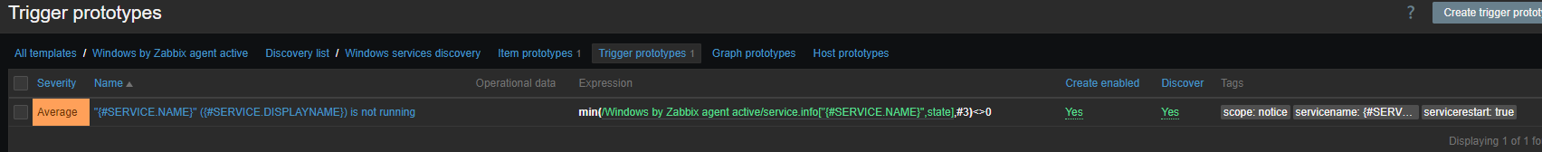

      Step 1
      Add new tags:
      Got to 'Windows by Zabbix agent active' template. (or whatever template you use)
      Go to Discovery>Windows service discovery>Trigger prototypes.
      There is only one entry in there for "service not running" Go into that and then tags and add
      "servicename" and {#SERVICE.NAME} for the value.
      "servicerestart" and "true" for the value
      This puts tags on the triggers with the service name that the script needs ({EVENT.TAGS.servicename}) and the "true" value that you use later in trigger conditions. Either run re-discovery or wait for a time and it will update all services with the two new tags.

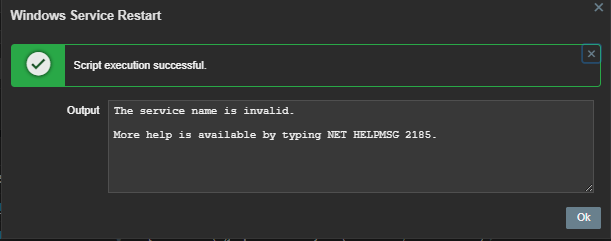

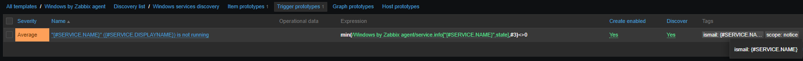

      • ismail.karagoz
        • Aug 2024
        Hi friend,
        We created the necessary objects but we are getting below error message.
        We have successfully checked the server names on tags ;
ID:	497471​We also add that event tag on the script;
        Do you have any suggestions to us?
        By the way thanks for your amazing effort. We have learned a lots of good information from this article ​
