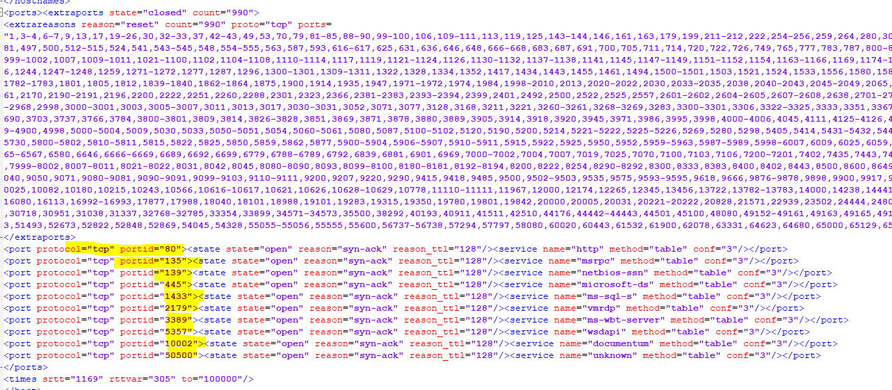

          XML:
          Click image for larger version  Name:	image.png Views:	1 Size:	85.6 KB ID:	470413​​

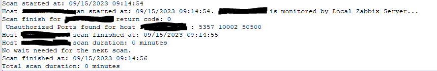

          Logs like this:
          Click image for larger version  Name:	image.png Views:	0 Size:	16.9 KB ID:	470416​​

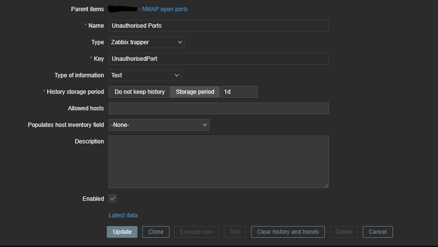

                for data:
                ​Click image for larger version  Name:	image.png Views:	0 Size:	24.3 KB ID:	470423

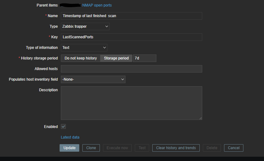

                last scan date/time:
                Click image for larger version  Name:	image.png Views:	0 Size:	24.5 KB ID:	470424

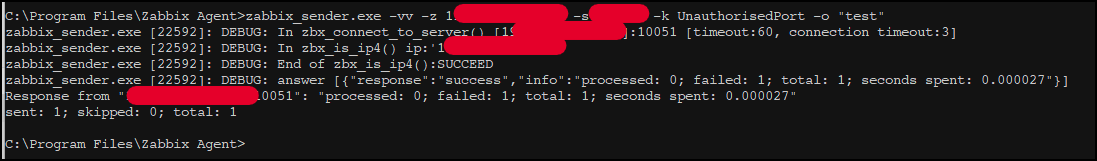

                  Below is output of zabbix_sender
                  • PeterZielony
                    PeterZielony commented
                    try adding -vv option after zabbix_sender.exe
                    it will give a clue what's wrong
