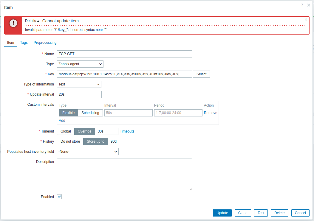

          ok,
          let's try to test, maybe I made a mistake somewhere in the configuration of the item key,
          item key: modbus.get[endpoint,<slave id>,<function>,<address>,<count>,<type>,<endiannes s>,<offset>]
          legend:​
          endpoint​ - tcp://192.168.1.145:511(fixed on router)​
          slave id​ - 1
          function​ - 3
          address​ - 500
          count​ - 5
          type​ - uint16​
          endianness​ - le​
          offset​ - 0
          modbus.get[tcp://192.168.6.145:511​,1,3,500,5,uint16​,le,0]​
          modbus.get[tcp://192.168.6.145:511​,<1>,<3>,<500>,<5>,<uint16​>,<le>,<0>]​​
          when I try to save this key the system gives an error, explain where I am wrong
            definitely do not use <>-s there... those are just for marking keywords...
            But I tried to enter one item and I got errors in any way and combination I tried... leaving out most of them, relying on defaults etc. etc..
            Exact same as you on v7 and a bit longer text on v6...
            : incorrect syntax near "". [items.php:690 → CApiWrapper->__call() → CFrontendApiWrapper->callMethod() → CApiWrapper->callMethod() → CFrontendApiWrapper->callClientMethod() → CLocalApiClient->callMethod() → CItem->create() → CItemGeneral->checkInput() → CApiService::exception() in include/classes/api/services/CItemGeneral.php:492]

              Two things you can try:
              - test with zabbix_get
              - Use "Named sessions", which are mentioned on Modbus integration page, but not mentioned on modbus.get page
              From here:
              Example item:
              modbus.get[tcp://10.6.4.51:502,1,4,13958,3,uint32,mle,0]
              I tried adding this item on my Zabbix, server accepts it [I do not have any Modbus TCP equipment].
              • piton4ik
                • Nov 2024
                • 17
                I inserted your key into a new Item and saved it, everything is fine,
                then I edited it to my real ip and other parameters, all it works, thank you
                  I think it is somekind of encoding issue... When I pasted both now to notepad++ and let it show "all characters"... this is what is shown..The one provided by troffasky worked OK for me also...
