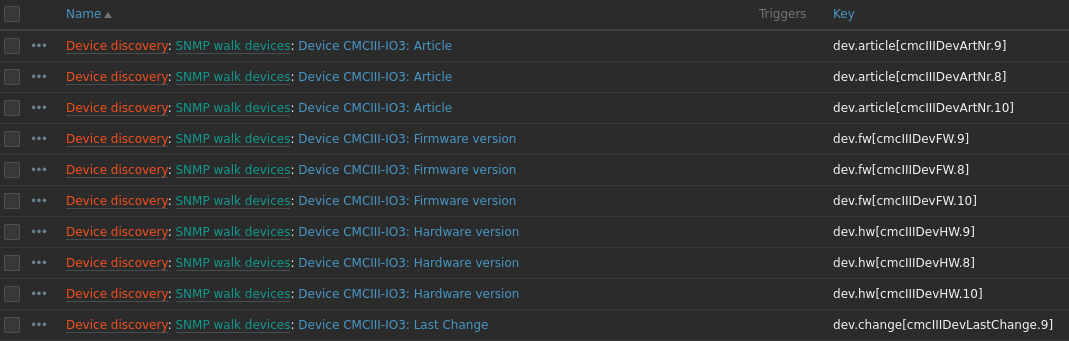

      I'm currently migrating our CMC-III monitoring to Zabbix. What a funny coincidence that you've just started developing a template for it. I am actually only interested in about 25 SNMP OIDs from our CMC-III, so I simply manually added these into a template, being happy with the result.
      I've tested your template with Zabbix 7.4, though, and I'd be happy to give some feedback.
      We run one CMC-III Processing Unity and three CMC-III I/O Units. I get a lot of values (151 items) from the "SNMP walk devices: Device discovery" report.​ Not sure whether this is what you had in mind (see attached image).
      Click image for larger version  Name:	1756905761.png Views:	4 Size:	97.7 KB ID:	506858
      In your template there is already an item "SNMP walk variable names​", which could be used / might be intended for the sensor/variable discovery.

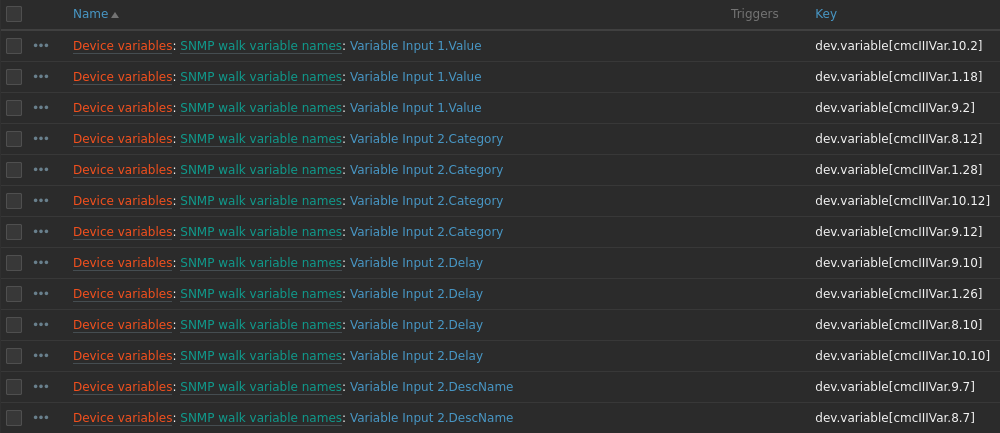

      For testing, I added the following to your template, to discover variables:

      With this discovery rule I'm getting:
      Click image for larger version  Name:	1756905977.png Views:	4 Size:	121.4 KB ID:	506859
      However, in the preprocessing SNMP_WALK_VALUE step, this 1.3.6.1.4.1.2606.7.4.2.2.1.10.{#SNMPINDEX}' is not valid.
      My OIDs are looking like this (which is the same sgtserge says for his temperature sensor):
      iso.3.6.1.4.1.2606.7.4.2.2.1.3.8.41 = STRING: "Input 7.Status"
      iso.3.6.1.4.1.2606.7.4.2.2.1.10.8.41 = STRING: "OK"
      iso.3.6.1.4.1.2606.7.4.2.2.1.11.8.41 = INTEGER: 4
      I guess I would need something like 1.3.6.1.4.1.2606.7.4.2.2.1.10.{#DEVICEID}.{#SNMPIN DEX}, but ​I'm not deep enough into Zabbix to understand how you would do this.
      I'm happy to test or provide example data if this helps.
