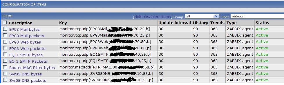

    So here goes! I have been working on a specialized agent which interfaces directly with LibPcap. The agent will allow you to monitor two types of packets on the wire, TCP/UDP traffic occurring on a particular port or traffic bound to an Ethernet MAC address.
    Before using the agent you will need to download and install the Ruby LibPcap libraries from http://www.goto.info.waseda.ac.jp/~fukusima/ruby/pcap-e.html
    Inside the tarball will be instructions for compiling and installing the libraries. Before running the agent you will need to edit line 293 "PacketAgent.new". The first argument is the IP address you want the agent to bind to, the second is the port, and the third is the arguments you wish to pass to the LibPcap libraries, this includes the Ethernet adapter you want the agent to listen on. Also the agent will need to run as root. It may run as another privileged user but I have not tested this.
    How it works:
    All information regarding what packets are to be captured is stored on the Zabbix server in the item's key. If the agent detects a new filter it will be added dynamically.
    *KEY POINT*
    In every key there is a field for name, this must be unique for each host you wish to monitor! This is how the agent knows which filter you are looking for. This will likely change in the future, but it made for a faster path to testing. Each filter stores byte and packet information.
    There are three key types:
    monitor.tcpudp[name,ip,port,p/b]
    name: This is a unique name for this filter
    ip: The IP address you wish to monitor
    port: The port you wish to monitor
    p/b: Do you want to store packets or bytes? Only p or b is allowed.
    Edit: The filter does not distinguish between TCP or UDP. It matches IP and Port number only, not protocol.
    monitor.macaddr[name,macaddr,p/b]
    name: The unique name for this filter
    macaddr: The mac address for this host
    p/b: packets or bytes to be returned
    zabbix.agent
    This returns some version information about the agent, this will likely change to conform to the standard agent string if it does not already. (I was too lazy to check)
    Some examples:
    Name: SomeHost Web bytes
    Key: monitor.tcpudp[SH_HTTP,1.2.3.4,80,b]
    Name: SomeHost Web packets
    Key: monitor.tcpudp[SH_HTTP,1.2.3.4,80,p]
    Name: SomeHost SSH bytes
    Key: monitor.tcpudp[SH_SSH,1.2.3.4,22,b]
    Name: SomeHost SSH packets
    Key: monitor.tcp.udp[SH_SSH,1.2.3.4,22,p]
    *Key: AnotherHost Web bytes
    *Key: monitor.tcpudp[SH_HTTP,5.6.7.8,88,b]
    Key: Router Mac bytes
    Key: monitor.macaddr[RTR_MAC,00:01:02:03:04:05:06,b]
    One of the entries is marked with a * for a reason to show a side effect of the name requirement. In the above example "AnotherHost Web bytes" would actually be storing the byte information for "SomeHost." The IP and port information are different but right now the agent keys on the name field.
    You will likely want to import the data as a delta over time.

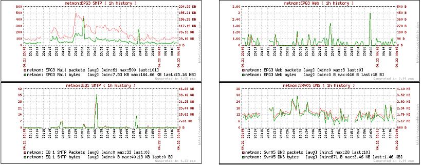

    Attached is a screenshot of some of the graphs, along with some of the items and the ruby agent gzipped.

      • nelsonab
        • Sep 2006
        • 1233
        I wanted to use IPTables originally but I just couldn't find documentation that explained what I needed well enough. On top of that if you were to use IPTables all traffic would have to flow through the box, using LibPcap you can sit on a monitor port on a switch and sniff the traffic as it floats on by so to speak. If the server running the agent dies the network is not affected.

        In the testing environment I'm running a Dual Core Intel with two VMWare instances. One is the server, the other is the agent. The Box itself has three NICs, one with an IP address to the network and the other two are plugged into mirror ports on two switches both without IP address.
        My next goal is to add a few more filter types, remove the name requirement and add support for multiple NICs.
