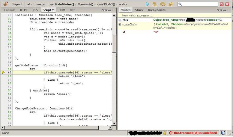

    1st Issue:
    Test with FireFox. If a user goes to
    - "Monitoring"
    - "Latest Data"
    - then select the "Select Nodes" button and expand the "Central" node.
    The following error will occur after the expansion of "Central": "this.treenode[id] is undefined":
    Select Node Button:

    Error:

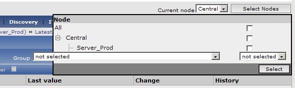

    In IE6 the "Select Node" menu is long or stretched and the group and host boxes are shown through the select node box. See graphic below.

    2. Ohh IE6 is just too buggy dropdown objects over popups is a known and serious bug in IE6.. I'll see what I can do here

      1. I actually see this error on every screen. Just tried "Configuration" -> "Items and also "Configuration" -> "Host" and tried to expand the "Central" node by clicking on the "+" sign in the select node box and got the error "this.treenode[id] is undefined". After the error occurs, I have close the browser and relaunch Firefox because it makes it unresponsive.

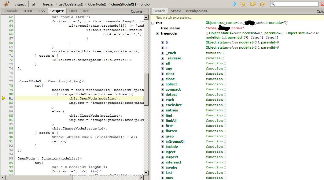

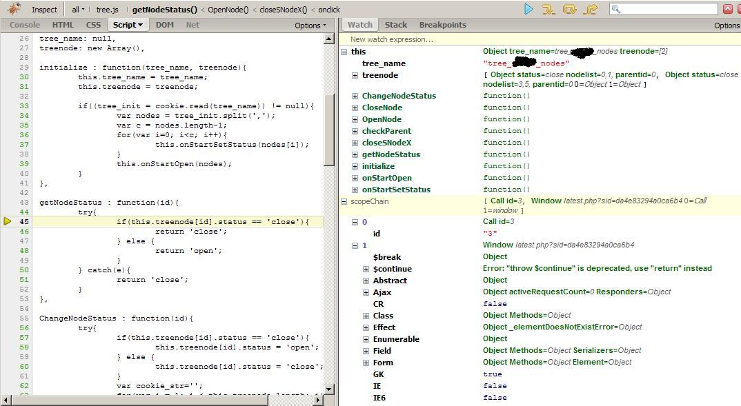

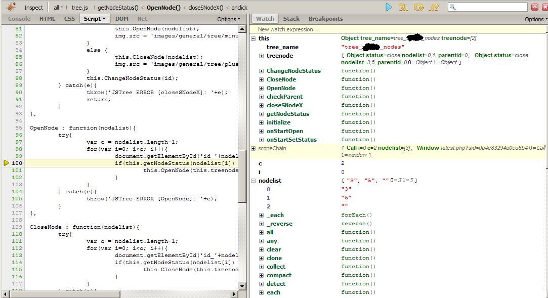

                Here are some Firebug screenshots that might help. Let me know if you need any more information from the "watch" panel.
                Looks like the following js functions are called:
                closeSNodeX() -> OpenNode() ->getNodeStatus()
                closeSNodeX:

                OpenNode:
                getNodeStatus:

                  Actually, I think that problem with js is a consequence of the 1st problem... The problem is that I can't reproduce it.. may be I can give you a php sript with debug info or tell you were to put it so I could "remotely" debug it?!

                    2. Looks like IE6 has an issue with "select" drop downs because they do not play by the rules even when using z-index values. IE6 puts "select" boxes on top of everything. Looks like the only way to fix it is by using an iframe with -1 z-index over the select box or temporarily converting the select boxes to span type and back to select.
                    Here is an interesting article about it:
                    Fixing Overlaying Layers with Dropdowns in IE
                    http://www.codeproject.com/KB/HTML/dropdown_div.aspx
                    I hope this helps. Not sure what is the best method to use in Zabbix.
