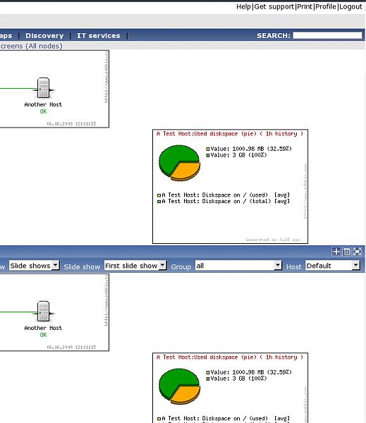

    two problems with slideshows in current trunk.
    create a slideshow, add two screens to it.
    1. slideshow delay/interval is ignored. watch this slideshow in the monitoring section - updates ignore configured elays, instead they seem to use something more close to what is set in the 'refresh' option (set in the upper right corner, 'menu' control).
    2. changing refresh displays multiple slides at the same time.
    change refresh using the 'menu' option (to 10 seconds, that way effect can be seen sooner).
    after approximately 10 seconds pass, slideshow changes... but now two slides are displayed at the same time - upper one is changed, but lower one always stays the same. part of the screen when this effect kicks in :
