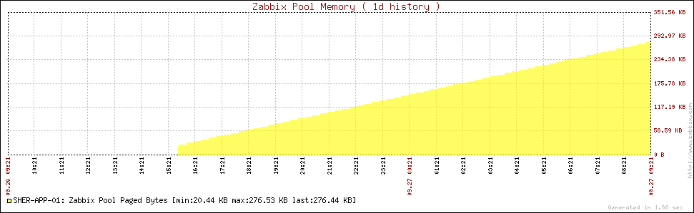

    Hi all,
    Refering to my other post (http://www.zabbix.com/forum/showthread.php?t=1338), I can't imagine that none of you are seeing this behavior.
    Can you all graph 2 items and post your results here after running for 24 hours?
    The items to monitor are:
    PerfCounter= Zabbix[WorkSet],"\Process(ZabbixW32)\Working Set",30 <-- This should remain stable.
    PerfCounter= Zabbix[PoolMem],"\Process(ZabbixW32)\Pool Paged Bytes",30 <-- This is always increasing.
    The problem i'm having is that the Pool Paged Bytes of the Zabbix agent is ever increasing and never releasing its allocated memory. After a couple days this render your server inaccesible and when trying to stop the Zabbix service results in a BSOD. This is hapening on all kinds of Windows installations (servers, workstations (all W2K Sp4))
    Attached you can find a graph of the Zabbix Pool Paged Bytes
    Please everyone, I realy love Zabbix, but i can't use it for the above mentioned problem.
    Feedback is highly appreciated.
