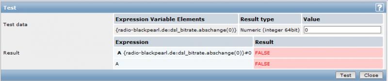

    im using 1.9.3 and tried to add a new trigger.
    What i want is that the trigger is triggered if last value != previous value, so i tried the triggertype
    Absolute difference between last and previous value NOT n
    and set n to 0
    If i understand it right, the trigger should become true if the difference between last and previous value is > 0 or < 0, for example 12 or -12
    When i try to test the trigger, i always get false as result (Test Trigger function on create trigger Tab) regardles what i enter as value.
    I have tried -10, 0, 10, and some other values but always got false as result.
    So i dont know if i did something wrong or it it is a Problem with that trigger.
    Greetz
    MAD

    please show the actual trigger expression

      For the expression please see the screenshot below.
      regardless of the value i enter (for eg, 1 or 10 or 100 or -1 or -10 or -100), the result is always shown as false when clicking on test.
      The value i want to Monitor is the bitrate of my shoutcastserver, a numeric (unbsigned) decimal value between 0 and 320 kbps, received as integer from 0 to 320.
      Normaly the value should always be 192 (192kbps). So i want to have triggered an info if the value change, for eg. to 128 or to 256.
      Greetz
      Martin

        i can reproduce this both on 1.8 branch & trunk - could you please report it on the tracker ? thanks.
        btw, i believe that server will evaluate it correctly, just the expression testing is broken
