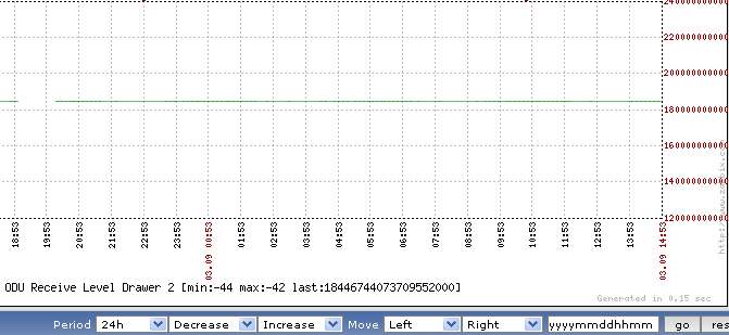

I've searched and see that negative item values have been broken for several of the beta releases. I'm curious if anyone has found a work around.
I'm polling via SNMP a variable that returns negative integers. Zabbix seems to collect and store the correct data, and will display the correct values in certain contexts (see the Min and Max numbers in the attached graph). However, when Zabbix attempts to display the negative numbers, both on the Latest Data page or as the Last value on a graph, it interprets it as an unsigned integer.
Any suggestions would be much appreciated.
