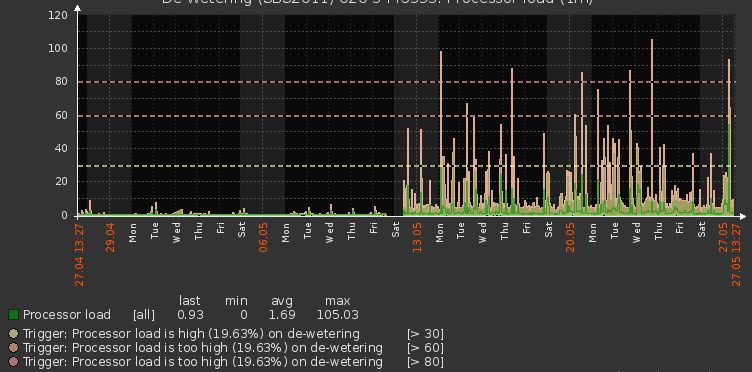

    I've added a screen-shot of the processor load...
    The first half of the month is the old Pentium Server which had a heavy job, the brand new Xeon is running smoothly.
    The graphs show opposite results.
