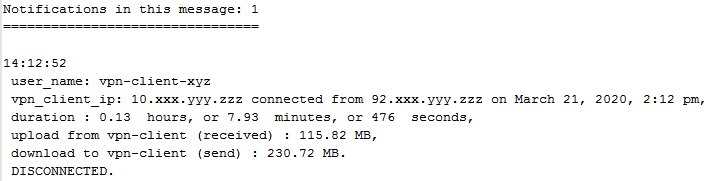

    Don't know how many users, but maybe you could mod something like this. One of the later posts includes data down- and up-loaded. But not pretty.
    https://forum.netgate.com/topic/1513...ct-common-name
