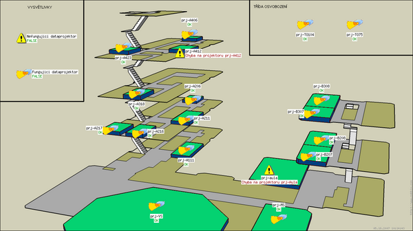

          OK. So we probably use bad scenario because of bad understanding how zabbix works. Only to be sure that I understand it, maybe good to know for another zabbix users:
          - We have some device which is not real host (does not have IP, like dataprojectors)
          - Our admin of this devices uses zabbix to set this host faulty or OK (using zabbix_sender) when device state changes.
          - Item errstate is string and has history set to 351 days
          - We have map of this, any user can look if dataprojector is OK (see attachement)
          - After zabbix server restart, triggers will be unknown and our admin has to manualy send all informations again by zabbix_sender (even if they are already in history).
          Am I right ? If so, I have to find another way how to achieve similar map.

            Nice map!
            You may set a refresh period to a very large number for these items in order to fool ZABBIX server. It should not set status of these triggers to UNKNOWN if the last timestamp of the items is not older than the refresh period.
