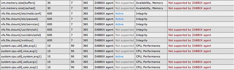

    I just added some Solaris hosts to my Zabbix 1.5 installation (with 1.5 agent) and am not able to read the cpu utilization from the agent. Zabbix is telling me that it's not supported. At matter of fact, the agent is telling me the same, when using the "-p" parameter.
    # ./zabbix_agentd -p -c /usr/local/zabbix/etc/zabbix_agentd.conf | grep -i cpu
    system.cpu.switches [u|593962952]
    system.cpu.intr [u|562557063]
    system.cpu.util[all,idle] [d|0.000000]
    system.cpu.load[all,avg1] [m|ZBX_NOTSUPPORTED]
    system.cpu.num[online] [u|4]
    The client host is a Solaris 10 x86 System:
    # uname -rvis
    SunOS 5.10 Generic_127112-11 i86pc
    Is there any reason, why CPU util. shouldn't be read by the agent? This is an absolutely mandatory value I need from the agent.
    Thanks in advance
    Winni
    PS: The "Active" for system.cpu.util[,system] in the screenshot is not true. I activated it manually but it will be back at "unsupported" as soon as I reload the page.

      accid:
      This is a known problem in 1.4.6. The attached patch fixes part of it.
      Doomshammer:
      Why are you still using beta versions ?
      Update to the latest version (1.6.4) and it will be fixed - more parts will work.
      See the Changelog in the sources.
