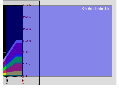

    Zabbix 1.5 - Graph Zoom Problem
    When viewing graphs when the browser window is in full-screen mode, the Zoom box keeps moving past the right edge of the screen. See attachment for a screen shot. This does not happen when the browser windows is not in full screen mode. Also, noticed that if you move the mouse to fast the zoom box does not keep up. I wonder if the sbox.js javascript can actually check to see the start and actual x-coordinate change to get a more accurate zoom box instead of increment the width by the pix variable. Just an idea.

    I have noticed problems after browser resize, also in IE if start selecting graph period(zoom-box) on image but not on graph itself. Those I have fixed.
    Problems in fullscreen mode like you described I haven't found..
    Fast mouse move I think is related that you move the mouse pointer out of the graph, the box then stops listening mouse movement. I think I will improve that but later.

      I did some extra test. Same problem occurs in Firefox. I made sure that I started the zoom box in the graph itself and started moving to the right. The zoom box keeps going until the edge of the screen and does not stop at the edge of the graph. For some reason it stops on the left side of graph area just fine. Maybe it has something to do with my video drivers.

                I'm still trying to figure this one out. Also, I noticed that if I select a zoom box, the selection is always off and to the left of the zoom box I created. As a result, I have to select to the right of what I want to see. Weird. Still looking into it.

                  Yeap, we found this bug, it's related to the displays with big resolution To be fixed.
                  update: fixed.

                      Work great, even at 1680 x 1050 in full screen mode. Thanks Aly for the great work.
