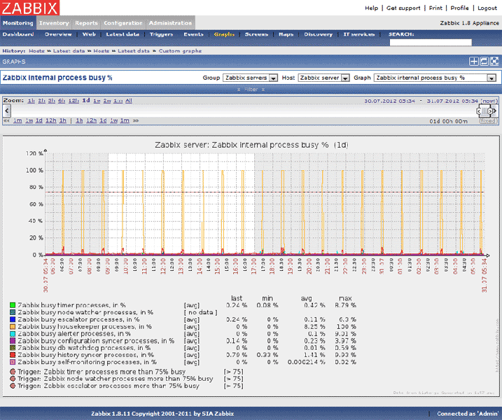

        The first thing I think you should do is (if possible) switch zabbix agent in active mode, so that your server don't have to do the pulling.
        The second thing you should do is place a template on your zabbix server to monitor internal processes (see the attachment).

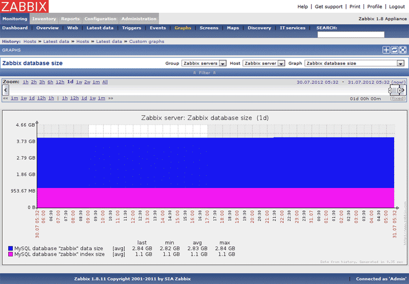

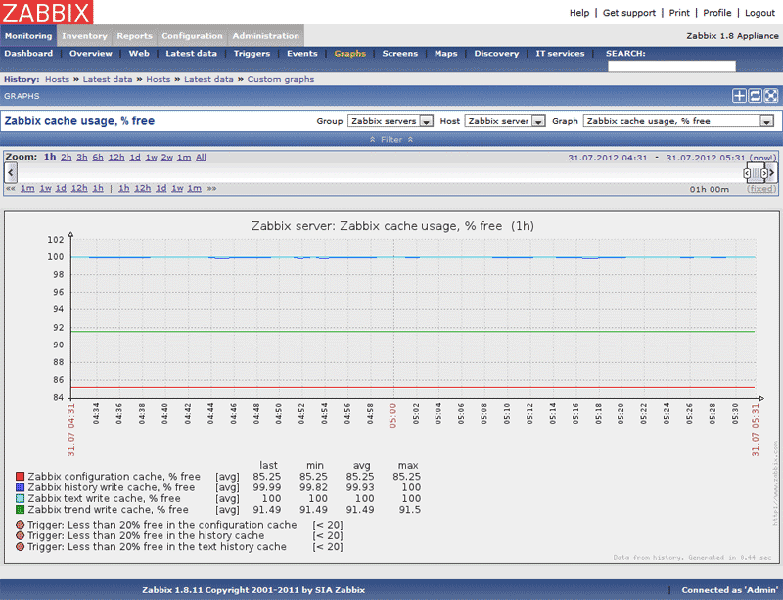

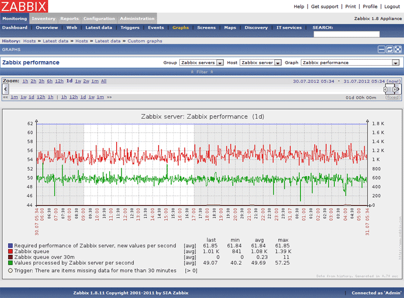

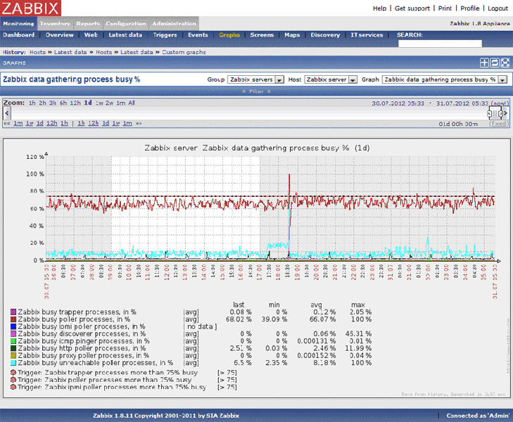

              I'll follow up with the graphs...
              • cheezus
                • Nov 2011
                • 35
                zabbix graphs
