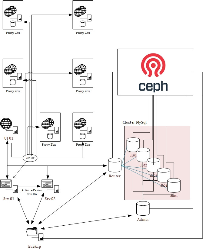

            Ok, i will tell you my current setup (non productive yet).
            I ve made a mysql innodb cluster consisting in five instances, one rw and 4 ro, with a mysqlrouter and an admin console. For storage ceph was elected.
            Two zabbix server, active - passive mode, one ui, and proxies for all =)
            I have partitioned most of the history tables.

                Well well well, after a couple of weeks for setting up the environment, its all working perfect,
                But i still notice the slow query x.yyyy sec, "commit" message on server,
                I attached the image of the infraestructure for giving you an idea on how i have mounted Zabbix.

                47518:20180911:123722.221 slow query: 3.022553 sec, "commit;"
                All db's server are 10 vcpu and 24gb ram
                zabbix server is 4 vcpu and 8gb
                If you can give me some clue, i would really appreciate. Zabbix now is a productive system
                Important values
                Number of hosts (enabled/disabled/templates) 4132 4030 / 20 / 82
                Number of items (enabled/disabled/not supported) 149941 114668 / 879 / 34394
                Number of triggers (enabled/disabled [problem/ok]) 3913 3883 / 30 [39 / 3844]
                Number of users (online) 5 1
                Required server performance, new values per second 2192.03
                Sorry for the giant email.
Name:	diagrama de la solucion.jpg
