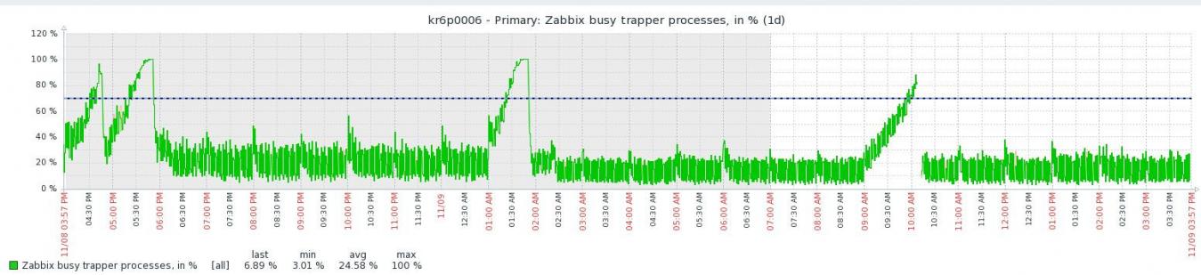

    We currently handle about 7000 nvps with our environment. This doesn't include a large amount of zabbix trapper items as well. We have recently started having and issue where the zabbix trappers on the our primary server will get stuck processing data. As more of them get stuck our busy trapper process monitor goes from aroudn 20% used to 100% used. Once we hit 100% we have to recycle the zabbix primary server to fix the issue.
    We currently have the starttrappers=50 and I'm wondering what other folks have theirs set to? Has anyone else had this problem and have some suggestions?

      Essentially what we've noticed so far through debug and tcpdumps that the trapper processes on the Zabbix primary are not stuck but they are just taking forever to process the data. We've been working on reducing that load. Let me know if there is any additional data that might help.
