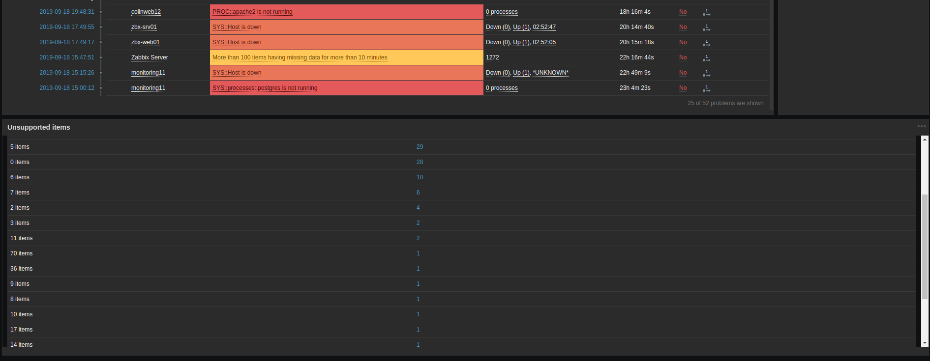

    Originally posted by splitek
    No way on dashboards, but why not use Filter in Configuration > Hosts?
    Just switch "State" to "not supported" and clear other options or choose interesting groups, app etc.
    Of course it is possible to have such data in dashboard
    Heree is the screenshot of the fragment of the dashboard which I have now
Name:	Screenshot from 2019-09-19 14-04-54.png
    • kloczek
      • Jun 2006
      • 1771
      Here is the instruction how to do that:
      - map to the host item zabbix[host,,items_unsupported] key
      - map that item to inventory entry
      - go to inventory entry to have URL of the page with agregated count of the hosts with exact number of unsupported items
      - add that URL (without sessionid) to the dashboard "URL" widget
      My OS templates and SNMP devices templates from https://github.com/kloczek/zabbix-templates have zabbix[host,,items_unsupported] OOTB and that item is always mapped to "Site Notes" inventory entry.
      Posted screenshot shows in first column how many unsupported items have some exact number of hosts listed in second column.
