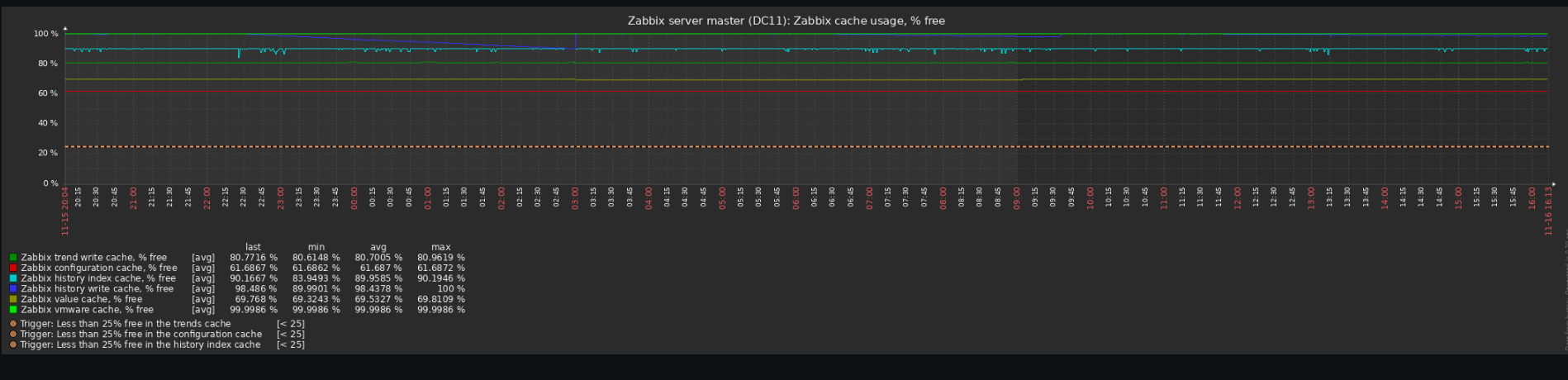

    Noticed that is related with Zabbix history write cache which is decresing during the problemClick image for larger version
