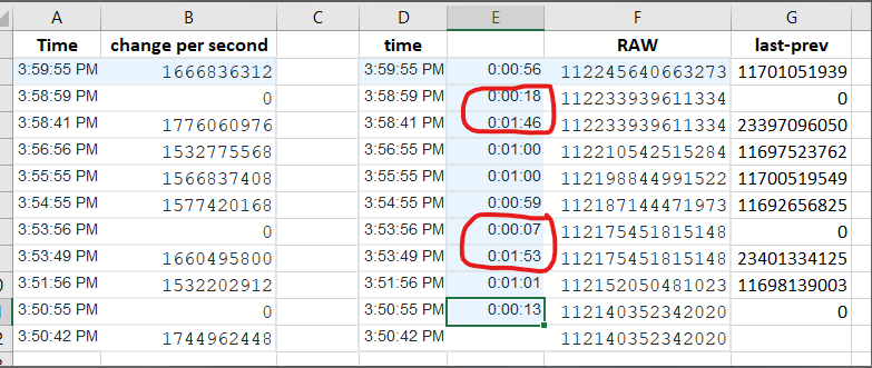

  • aib
    • Jan 2014
    • 1615
    There are a couple of screenshots that support my initial post.
    1. Update interval configured for interface HundredGigE0/0/0/30
    2. Small piece of history showing two items together - "Change-per-second" and "RAW" data from SNMP pull. Click image for larger version
    Sincerely yours,
    Aleksey

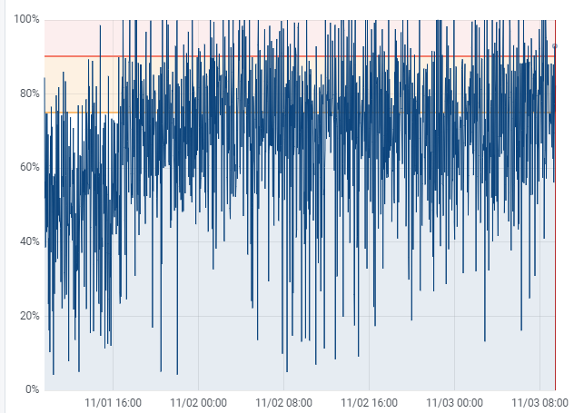

      • aib
        • Jan 2014
        • 1615
        Utilization graph for last two days for proxy is attached.
        Average load = 82%,
        Min load = 4%
        Max load = 100%
        ​​​​​​​Click image for larger version
        Sincerely yours,
        Aleksey

                • Markku
                  • Sep 2018
                  • 1786
                  So, my understanding is that the pollers (as configured with StartPollers) are responsible for doing the SNMP polling and assigning the timestamps to the results. The poller utilization graph from the proxy showed that that the pollers are very heavily utilized. Thus, the number of pollers should be increased, provided that the CPU capacity is sufficient, too.
                  Anyway, in this large system all the Zabbix system metrics should be fully monitored and understood to be able to keep the system running properly.
