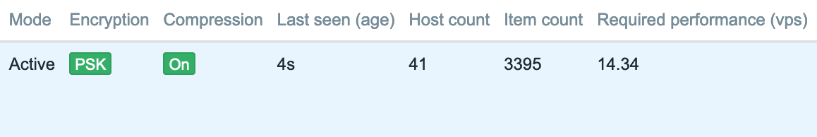

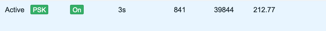

    Hi all, a this moment our Zabbix infrastructure has this design
    Click image for larger version  Name:	oNy2oS0.png Views:	0 Size:	173.4 KB ID:	459331
    Zabbix Version is 6.2.7 on all nodes (server & proxies)
    - Virtual MachineZabbix Server + Frontend + Database on RedHat 8 with 4cores, 12gb RAM (with MySQL Partitioning)
    - Virtual Machine Zabbix Proxy Building num.1 + Proxy Database on Debian 11 with 6 cores 12gb RAM, monitors all vlans on this building (firewalls + switches + routers using snmp & snmptraps, windows + linux using zabbix passive). Monitors about 800 devices

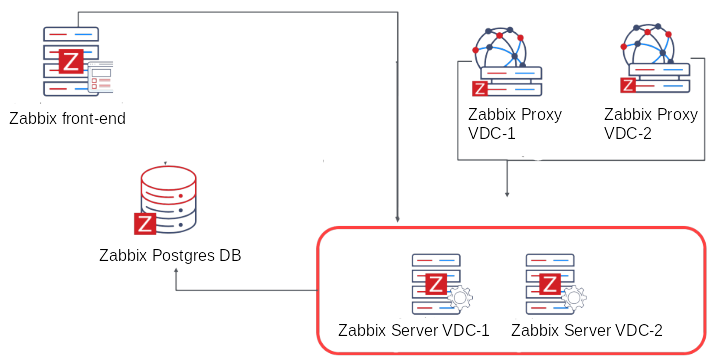

    Well we have about 350 hosts in 2 location VMware Cloud director and we do it like this
    The JAVA gateways are missing in this picture they reside on the proxy's. SRV en PRX have 4 CPU 16gb MEM. Web had 2 and 8GB,
