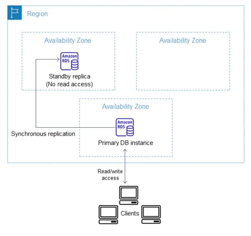

    I have used the Multi-AZ DB instance of AWS RDS as zabbix backend database, this solution provides high availability and failover support for DB instances with a single standby DB instance.
    This solution is equivalent to the Zabbix standalone deployment solution, only one DB instance provied read/write service for zabbix server.
    The difference is that AWS guarantees the availability of this database instance and switches to another standby instance in case of its failure.
    This standby instance will always synchronize data from the primary instance, but cannot be accessed
    This highly available solution is very stable, with a maximum failover time of no more than two minutes.

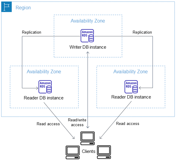

    As for Multi-AZ DB cluster solution, I don't recommend it for the simple reason that zabbix is not suitable for this kind of scenario that requires read and write classification.
