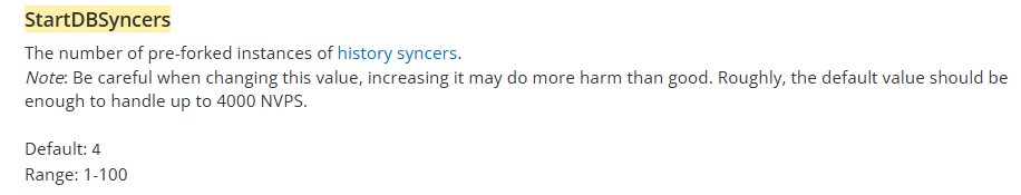

      Considering the Best resources we can provide and best configurations (Using Nginx, Postgres with TSDB, Partitions, Proxies etc) still Technically will Zabbix server engine/schema could able to handle such large volumes of DATA (350K NVPS)?
      I was going through the Documentation and found that there is a parameter Which technically answers my question :-
      the Parameter is "StartDBSyncers" which Technically says that Zabbix server could handle 1000 NVPS volume per 1 Syncer. Then only we can configure max of 100 to that parameter which puts a cap of 100 * 1000 NVPS = 100K NVPS volume handling capacity.
      So I hope the limitation of Zabbix is it can handle up to 100K NVPS per Zabbix server.
