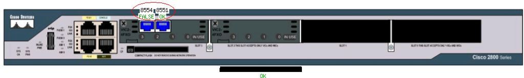

    Hi @:
    Is it possible to create a "host" or "trigger" inside the "Map" without put any label that associate to that host or trigger?
    As you can see on my attached picture, *in the circle one*, it will be nice if i can get off the label for each "FXO port" but i'll keep the label for "Router" one.
    TIA
    BEE

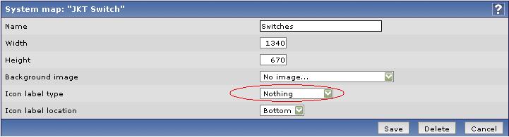

        Did not work for me using Zabbix 1.6.1.
        Warning. Incorrect value for [label]

          You need to entry label's value of your host. On map configuration, ensure you set Icon label Type to 'Nothing'

          • Floppe
            • Feb 2008
            • 14
            Oh, nice. Didn't cross my mind to look there. Thank you!
