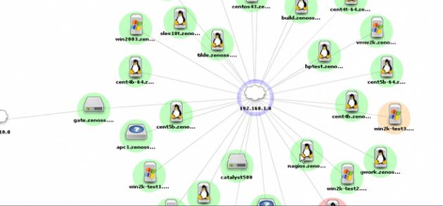

    Hello community!
    Is it possible to realize the same feature in Zabbix like it realized in Zenoss (see attachment) - colour indicate of elements on maps? Colours depends of element's triggers severity, e.g. yellow - information, orange - high, red - disaster and so on. Thanks for any sugestions.

      • evgeny elkin
        • Jul 2007
        • 52
        Icons indicates a status of a object - on, off or unknown, but i told about triggers severity indication. In short - viewing map i want to know about level of trigger's severity , like in 'Owerview" panel .

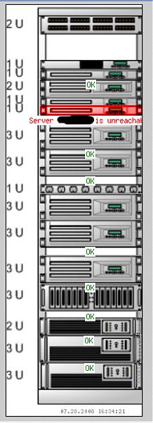

          Well, I`m certainly not a coder, and know next to nothing about PHP, but this ugly fix works for me.
          For zabbix 1.5.3:
          1. open map.php;
          2. search for this code:
          PHP Code:
          if( ($img = get_png_by_selementid($db_element["selementid"])) )
          ImageCopy($im,$img,$db_element["x"],$db_element["y"],0,0,ImageSX($img),ImageSY($img));
          3. delete it;
          4. few lines after that change this:
          PHP Code:
          $color          = $el_info['color'];
          to this:
          PHP Code:
          if (
          $color == $darkred)
          ImageFilledRectangle($im,$db_element["x"],$db_element["y"],$db_element["x"]+ImageSX($img),$db_element["y"]+ImageSY($img),$gray);
          if( (
          After that every element with red label on the map would also had filled gray background. You should use icons with transparent background, like "Notebook" from standard set.
