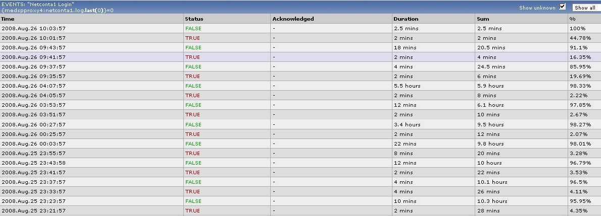

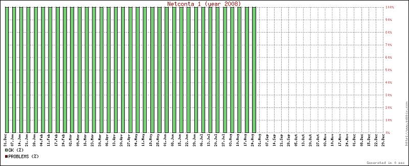

    How to IT Services
    My IT services is always 100% someone could help
    The next screenshot

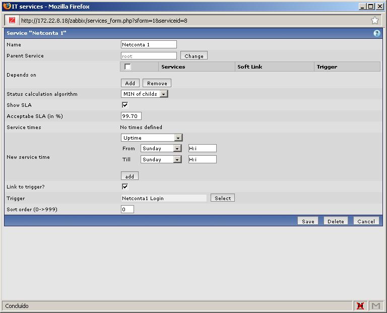

    Try setting 'Status calculation algorithm' to Max of child.

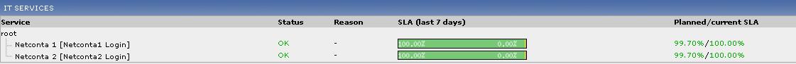

        Thank you
        I'm using zabbix 1.5.4 to generate the SLA. This working perfectly
